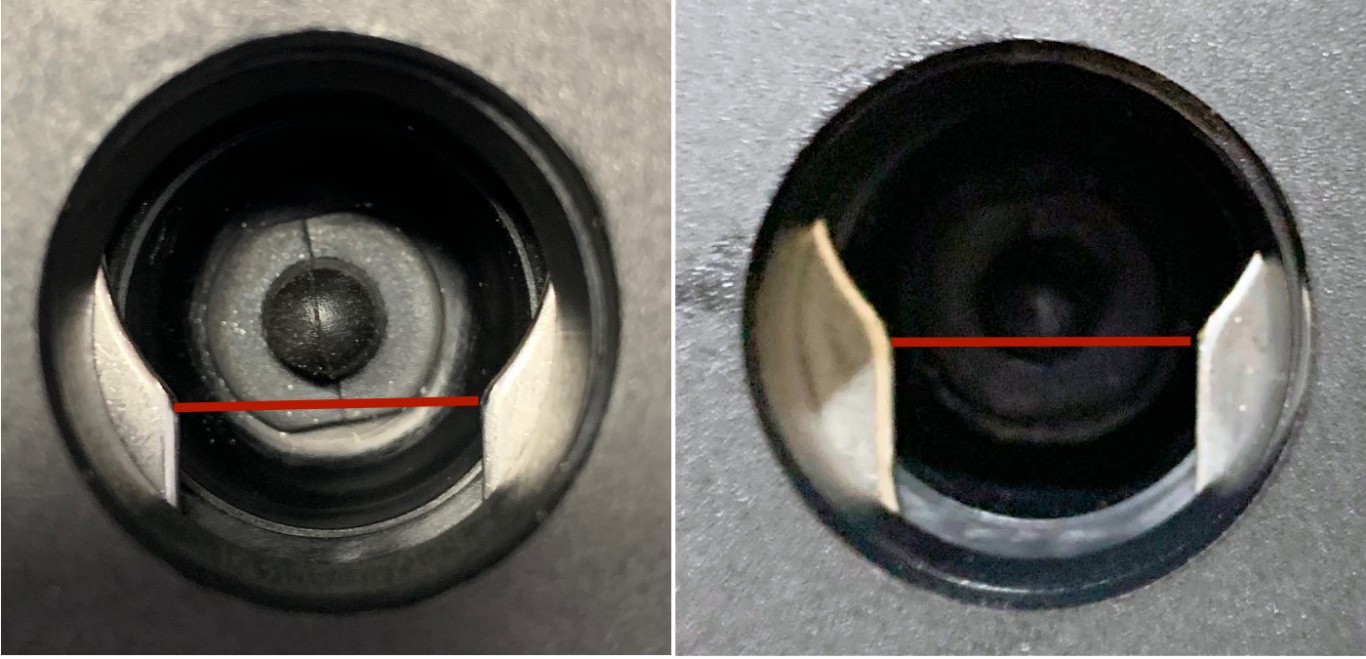

I assembled them myself including keying. Yes there is a little bit of adjustment in the lower mounting bracket but even after I completely unscrewed it from the inside so the only attachment was the mushroom head, I still couldn't get it off by jiggling. After completely unscrewing the latch box from the hard case so that was all that was attached I was then able to force it off at an angle.
I think I just happen to have a manufacturing run with very minimal tolerance. Interestingly once off I tried wearing the mechanism in a bit by opening the latch hard and repeatedly about 100 times. Attached photo comparison shows that it appears to have increased the amount of throw of the latch tongue. Left shot is after wearing in and right is just after I got it off. But would be great if someone else could upload a photo of one that works easily. Now I have to get the other side off.

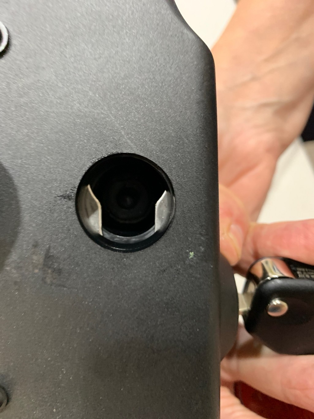

3
Thanks everyone for tips. Alas I could not get either to release no matter how much pressure. I disassembled one case from the inside so that I could get at the latch. Was able to just force it off by forcing the catch slide to move just a fraction further back.
Attached photos showing locked and unlocked positions of the slide concern me as you will see the amount of movement in the catch slide doesn't look enough to completely release the mushroom head. The key only moves 1/8 turn and to me it looks like I am not getting enough movement of the slide to get past the flange of the mushroom head. It is not a keying issue as even a screwdriver in the lock can't twist it more than 1/8 turn so it is an internal limitation. Can any of you tell me how much movement you get and that will help me rule out there being a problem with the internals.
thanks

6
Modifications, Accessories, and Appearance / Re: Factory Soft Side Cases
« Last post by Jggpossum on Yesterday at 04:35:51 AM »
I also have the soft cases and like the size and profile compared with the hard shell which was just too big and dominated the bike. Just as some others have commented I found them quite challenging to clip into place as there is a thick rubber pin in the middle of the case attachment which presses hard against the face of the mushroom mount. Great idea to prevent rattles, but it takes some serious pressure and jiggling to get them to clip in.
Today I tried to remove them to do a thorough clean and I can't get them off. I think the fit is so tight that the catch won't release and I almost broke the key. Has anyone got any tips for getting these off? Typical German engineering - beautifully over engineered to the point of almost being impractical to use.
