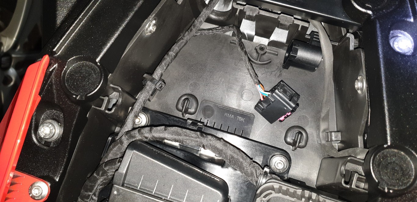

    First of all, connector in the front of the bike located with out any problem.
    Connector 1718555-1 under tool kit not found. I've only found the canbus connector as somebody mentioned:

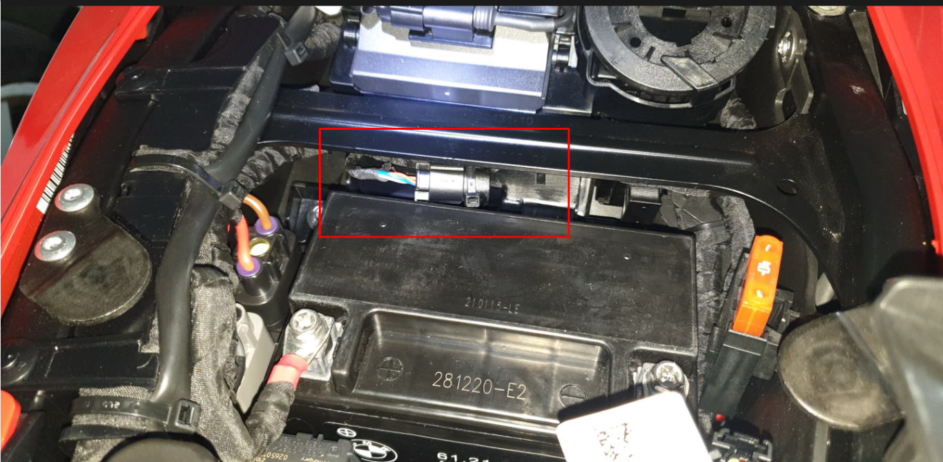

    However i've found another unused connector. Neither is 1718555-1. Is located just in back side of the battery, under the structual crossbar:

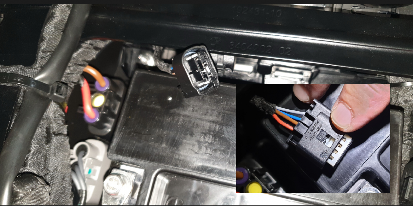

    The connector is different from the other one:
    Any idea where 1718555-1 is hidden?
